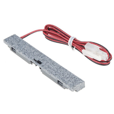

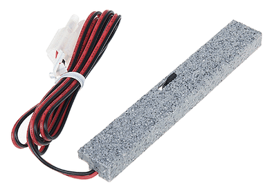

Are are kato 2-503 and 2-504 switch machines interchangeable?
It seems like anytime I need a couple, they are OOS on the one I need, but plenty f the other. I have 2 side by side right now, and they appear identical, with the exception of which end the wire comes out of. It LOOKS like they should be interchangeable. Anyone know?

I get that. I just bought 5 RH - they were out of stock everywhere until 2 weeks ago.
But looking at them, the APPEAR interchangeable. I guess I’ll test them out tomorrow.

https://lombardhobby.com/kato-ho-unitrack-2-504-right-hand-dc-turnout-machine-1-pc/
https://lombardhobby.com/kato-ho-unitrack-2-503-left-hand-dc-turnout-machine-1-pc/

I tested them last night. They ARE interchangeable with 2 caveats:
  1. When you use the LH in the RH turnout (or vice-versa), the wire exits from the “other end” of the machine. I can’t imaging that would matter to anyone, but it does.
  2. If you use them interchangeably, they are wired in reverse polarity. In my case, I use DPDT Momentary marine switches, so it doesn’t matter. If you use Kato’s switch levers, you might want to swap the wires. In other words, with one machine pushing the switch up moves the frog right, and with the other it moves the frog left.
For most folks, they are for all practical purposes interchangeable. They fit fine. In my case, I invariably have an extra right and need a left, or I have an extra left (or 3) and need a right. Most of my turnouts are manual. I only put machines on the harder to reach ones.
