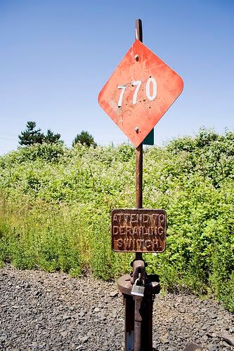

I would appreciate any tips or thoughts on this, or pictures of such things where they exist. Only found these two instances, and I don’t think they necessary refer to a switch number designation.

I’ve seen class yards with track numbers cut from old license plates nailed to the switch ties (Conrail’s Bayview Yard in Baltimore comes to mind). Have also seen track numbers painted on switch targets, but don’t recall if it was on railroad-owned or industry- owned trackage. It was pretty common to see switch numbers (not track numbers) stenciled on switch motors at interlockings.
Interesting pictures. Broom hanging on target in top photo and derail reminder in the bottom photo.
