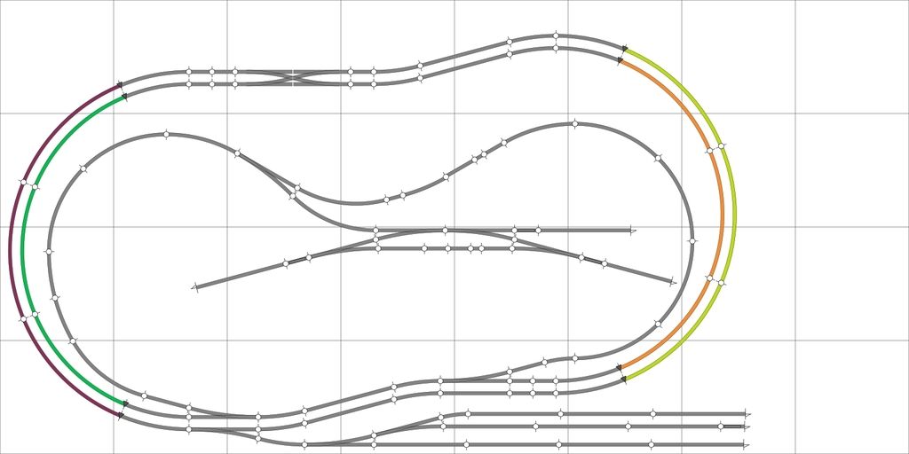

I live in a Townhouse and don’t have room for a permanent layout so I’m going to build a layout I can store behind a cabinet. No scenery, just track. I’m using Kato track and planned on nailing them with Atlas track nails directly to plywood. The layout size will be 6.6’ x 4’. Do you think the track nails will hold the track in place sufficiently or do you think gravity will rip them out when I put it vertical? Below is the layout plan.
