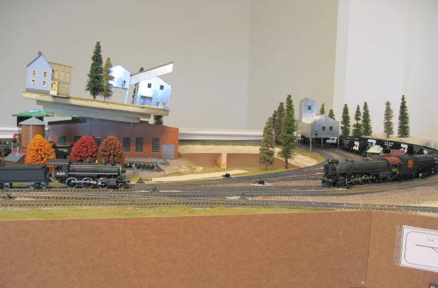

For my room filling layout (around the walls with a “hole” in the center for operators), I knew that I could not easily reach the wall areas, especially in the corners. However, I keep a 12x12x14 carpet covered wood box that I use as a step which makes access to the wall areas fairly easy.
However, I still can’t easily reach the corners. My solution - the same I used for 14 years on the current layout’s predecessor - was to make sure that there was no turnouts or poor trackage or potential scenic problems in the far areas of the corners. This certainly worked for me, and I recommend it.
In building the layout, I worked from the outside inward - especially in putting down structures and scenery. Again, this method worked like a charm for me.
