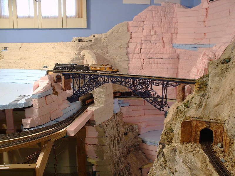

Here is a more elaborate styrofoam application

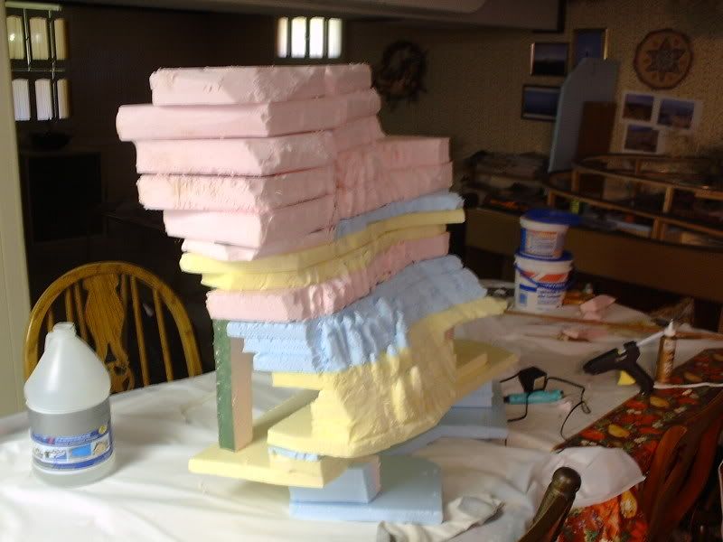

Here is a piece being carved at the bench to be set in place later after painting

On the new section I used a moduler type bench. it is over kill using 2 X 4. I then used 1/2 plywood then 2" foam over the top of the outside for the A line. Reason I used the foam is so I can cut some lower detail on the base of the A line.
More than likely I will cover the foam with drywall compound with some brown paint mixed in so it is not white. Detail rock sections with latex paint then cover sections that I want grass with white glue and shack on green ground foam to my liking. Use more than one color for the grass and all so look at the driffrent texures. They are normal fine, medium and course. (spell check)
