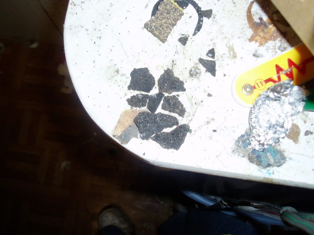

I finally have a photo of it! Although I broke it cause I didn’t really have for it. But
hopefully these fotos are good enough to see the final product.

do you have pictures of the finished asphalt?
I’ll try and get some pictures posted.

Nevermind. How come nobody likes my method? GOd! This is what I come to after I almost I had heat stroke?
Hey I for one appreciate your efforts to share a technique with us. It would help however if we had some pics to look at showing the final product and maybe the process.

Hard to evaluate the method without photos. Of interest, I did something similar by spreading sand over wet black paint to create a parking lot. I was looking for a “gravel lot” look, but it ended up looking more like asphalt than some of my deliberate asphalt efforts.
I would recommend trying different shades of grey instead of just flat black though - very few asphalt roads are black very long.
