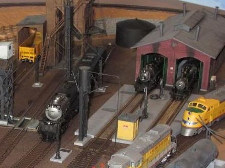

I went with dual flextrack between the 3 platform sections. I used stripwood from Hobby Lobby as 2x lumber planking with the track. Four strips fit nicely between the rails and one strip on the outside. Here’s a photo:
