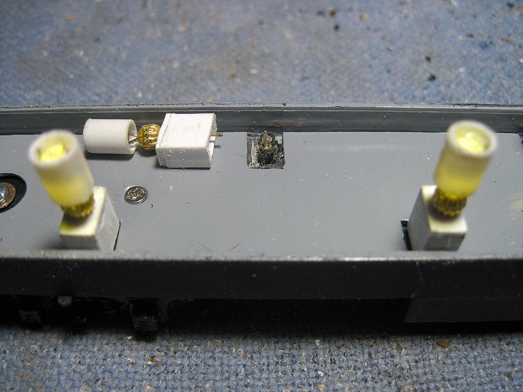

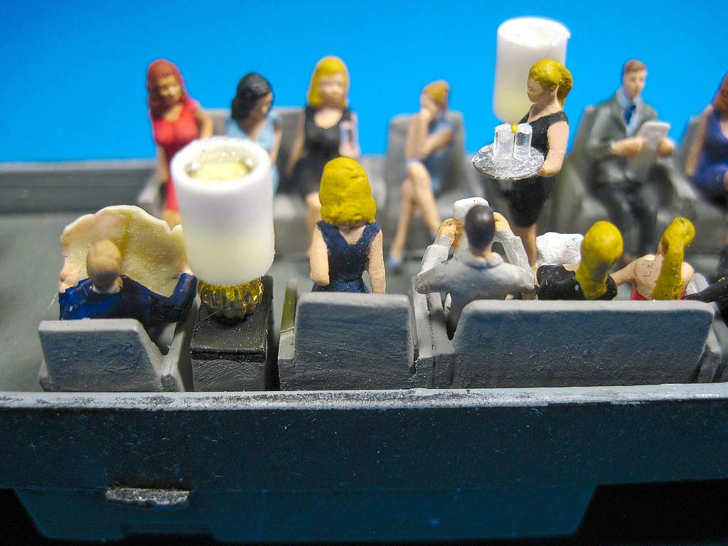

This is what I’m working with.
Previous kitbashed diner to lounge.

i understand exactly what you mean. i just did a walthers baggage lounge and in the bar area the figures are not super apparent even lit.
Those lamps are great!
As is the whole scene.

The table lamps work great with no refraction problems.

I made them.
I have about 25¢ tied up in parts for one complete table lamp.
The first couple drove my crazy, after four or five they got easy. I drive them off 4 volts, my standard lighting voltage in my passenger cars. I tried ⅛ watt resistors but they are too big so I ended up with 270Ω 1206 SMT resistors, remember I’m using 4 volts.
I put a 20 turn 5KΩ wire trimpot in every car to make the final brightness adjustment.
If you need more info send me your email in a PM.
