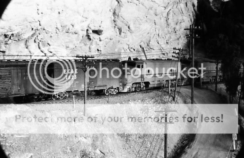

As far as I’m aware, the Globe diesels were only in plastic (I had an A-B-B-A set, originally in Santa Fe “Warbonnet colours”). I later re-painted them as CPR locos, and later still, re-did them for my freelanced Elora Gorge & Eastern…
One of the B-units was the only one powered, using a Lindsay motorised truck.
