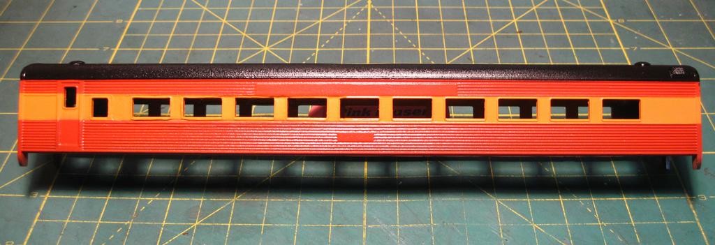

I’ve done the window thing on a Athearn passenger car. It wasn’t as difficult as I expected.
It came out pretty good but I thinks it’s a one time event for me.
