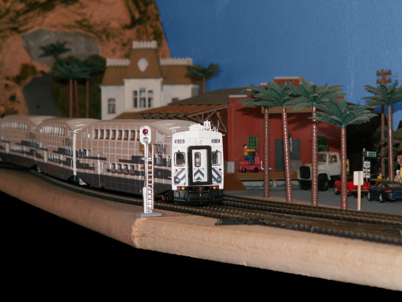

Has anyone tried to make the Athearn Bombardier coaches ride better on the track? These derail often. It’s not my track as everything else on my railroad runs without any issues. Has anyone just swapped out the trucks for another brand? I would like to keep them, but if nothing can be done, I may get rid of them.
