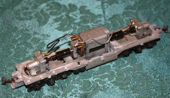

Always heard of these, seen pictures in instruction manuals, but today I finally got one in my hands.
Man, what a piece of machinery.
The gearboxes are all metal, screwed together, oillite bearings on the axles, worm gear shaft, and worm shaft.
The frame is something to behold.
Heavy!
Motor is at least twice as big as anything I’ve ever seen in an Athearn before.
I am taking it apart piece by piece, filing flash, cleaning out old grease, re-lubing as I go.
I have an old GN shell that fits, all done with handrails.
I will post when I’m done, but the gearboxes turn so smooth by hand…what a deal this is.
These were made in 1957, makes it exactly 50 years old.

Well, got it de-flashed, glass beaded the chassis, painted the chassis, cleaned and re-assembled the parts, cleaned the wheels and ran it.
Quieter by far than a gear-drive Geep we have from the early 70’s.
Pulls like crazy.
My guess is this was too expensive to build in the face of cheaper plastic stuff. It is reminiscent of the old die-cast Varney F-3 drives.
The photo shows the chassis above, with one truck, the second truck in pieces, and the HUGE motor off to the left.
So how does it “shift” gears? Did it look like this before you disassembled it:? I didn’t realize they were dual geared.
What model gp is it, and where can I get one!? [dinner]
I’ve never seen one before. Are those metal or plastic gears? Looks like a tuff little beasty.
Frame, tank air and fuel are GP7/9. Is that your shell?

That was back when they offeredn them two ways - gear drive or rubber band “hi-fi” drive. The rubber-band drives have one advantage over that gear drive - the ruber-band units pick up power on all 8 wheels. Those gear drive models only pick up from 2 wheels in each truck.

I had several of those drives in the early 60s…Advanced modelers would re-power Athearn with a Hobbytown of Boston replacement drive.
The reason that was called a “duel gear” is it was 8 wheel drive unlike most 4 wheel drive locomotives of that era.It was a marketing gimmick.
Yeah, dual-geared is two gear towers.
The spur gears off the main shafts are plastic or Delrin (did they have Delrin 50 years ago?), but the worms and shafts are metal.
