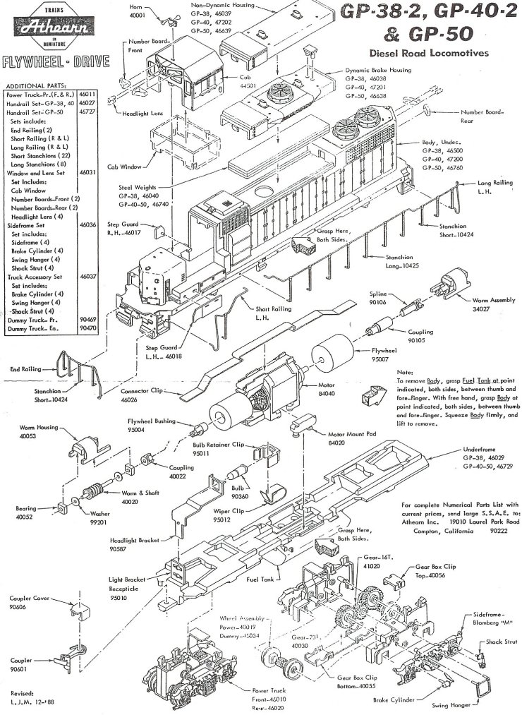

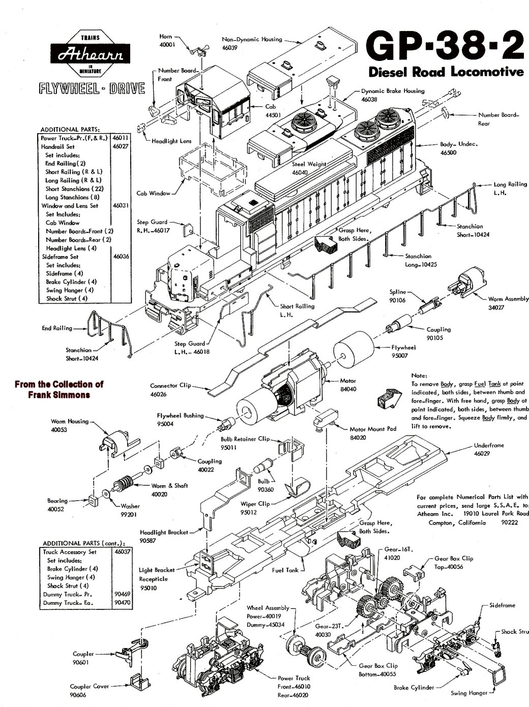

I take it that this model does not have the older style round loops that engage pins on the chassis? Looking at the HOSeeker site, it appears that Athearn had two different GP38-2 models. The first had the coupler mounted underneath the frame extension as shown here: http://www.hoseeker.org/assemblyexplosionAthearn/Assembly%20Explosion%20Athearn%20GP38-2.jpg , and the second had the coupler mounted on top of the frame extension as shown here: http://www.hoseeker.org/assemblyexplosionAthearn/Assembly%20Explosion%20Athearn%20GP38-2%20GP40-2%20GP50%201988.jpg.
In either case the pilot has a slot that allows the shell to slide up off the chassis. What I would look at doing would be to modify the coupler mounting to accept an appropriate Kadee coupler and associated box. This would involve drilling/tapping the frame extension for a machine screw that could be inserted through the coupler box from the bottom into the frame extension in the case of the earlier model. In the case of the later model you would have to come up with a way to basically do the same thing, except that you would need to find a way for the screw to again enter from the bottom.
What you are trying to accomplish is to have a way where the coupler can be mounted to the chassis after the body is on. Once you have come up with a way to do this, then you can frame out the bottom of the slot in the body shell. The prototype naturally does not have this slot. Once the slot is framed, then you can install the body shell, slip the coupler box through the framed opening you just created. and the coupler assembly will keep the body and chassis together. Then you won’t need those tabs. Many of the newer engines out today use the coupler b
