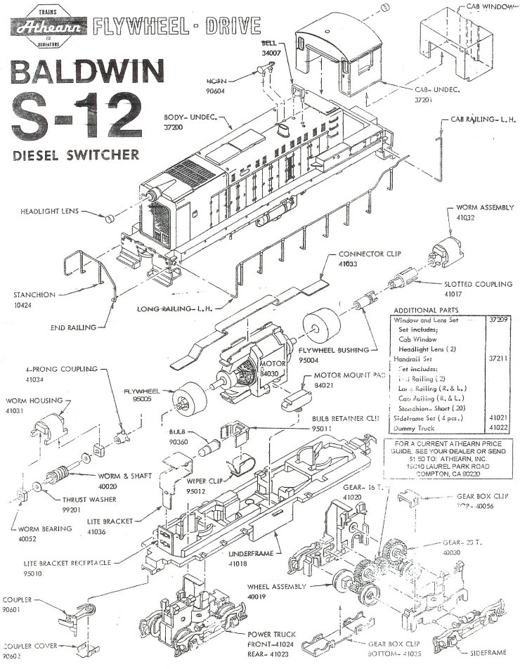

I experienced the disappearing part phenomenon the other night. While removing a power truck from an old Athearn Blue Box Baldwin S-12, I somehow managed to catch part of the worm gear cover clip on the inside edge of the chassis. I heard a “pop,” then absolutely nothing. As I was working in a rather spartanly furnished dining room with sheet vinyl flooring, I would have expected to hear the stupid thing hit the ceiling, the walls, and eventually the floor. However, not a sound! I spent an hour crawling around the room looking for the worm cover but could not find it. I even looked on top of the china cabinet and in the tops of the window blind frames - still nothing. Looking on the Athearn website, I do not see anything specifically listed as a worm gear cover clip (though they do specifically list the other two cover clips for power trucks). Does anyone know exactly what Athearn calls this part so I can order it from them? I sent an e-mail to Athearn with this inquiry last week but have not received any response. Does anyone have a broken Blue Box four axle loco I could salvage this part from?

I have an exploded parts diagram of a ready to roll engine. The part is curved on the top. It is called a worm housing. The part number is 40053. Good luck.
How old is “old”? If what you have looks like this, http://www.hoseeker.org/assemblyexplosionAthearn/Assembly%20Explosion%20Athearn%20S12.jpg, you should be able to identify what you need.

Heres what you need to order…
http://www.horizonhobby.com/Products/Default.aspx?ProdID=ATH40053
And yes one size fits all.
Now,here is a suggestion…To help cover shipping I would order other common parts for emergencies.
Thanks guys for the quick response! Maxman nailed it with his exploded diagram of exactly the model I’ve been working with. Since I live fairly close to Carson, I guess the next question would be whether I could pick the #41031 Worm Housing up at will call? Thanks again guys!
