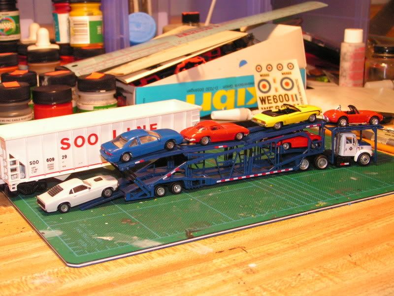

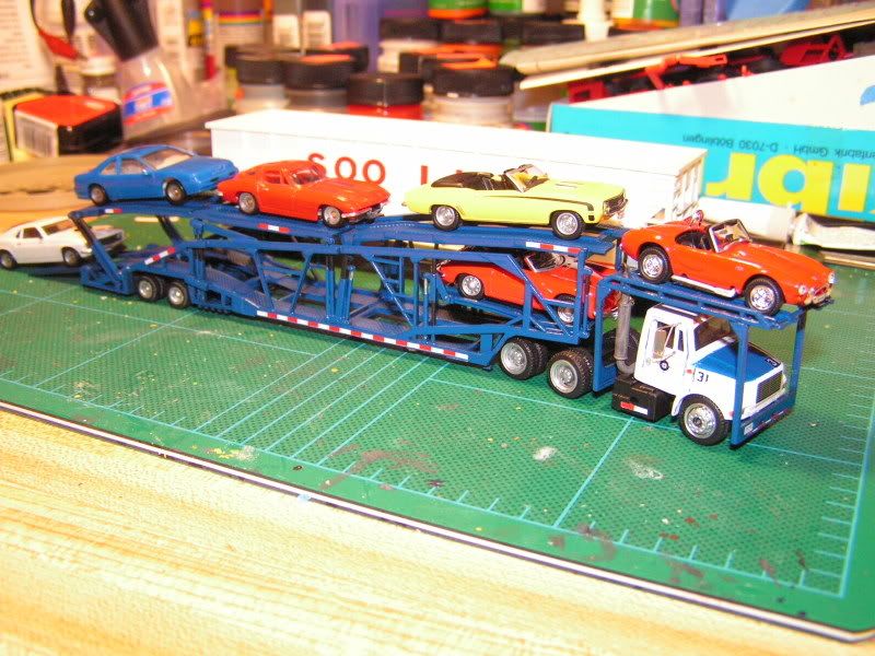

Here some addtional pics showing it next to a HO 70T hopper by Con-Cor. I also threw a few cars on it.
Thanks for the picture looks great all those american muscle cars a Cobra and a Corvette.
