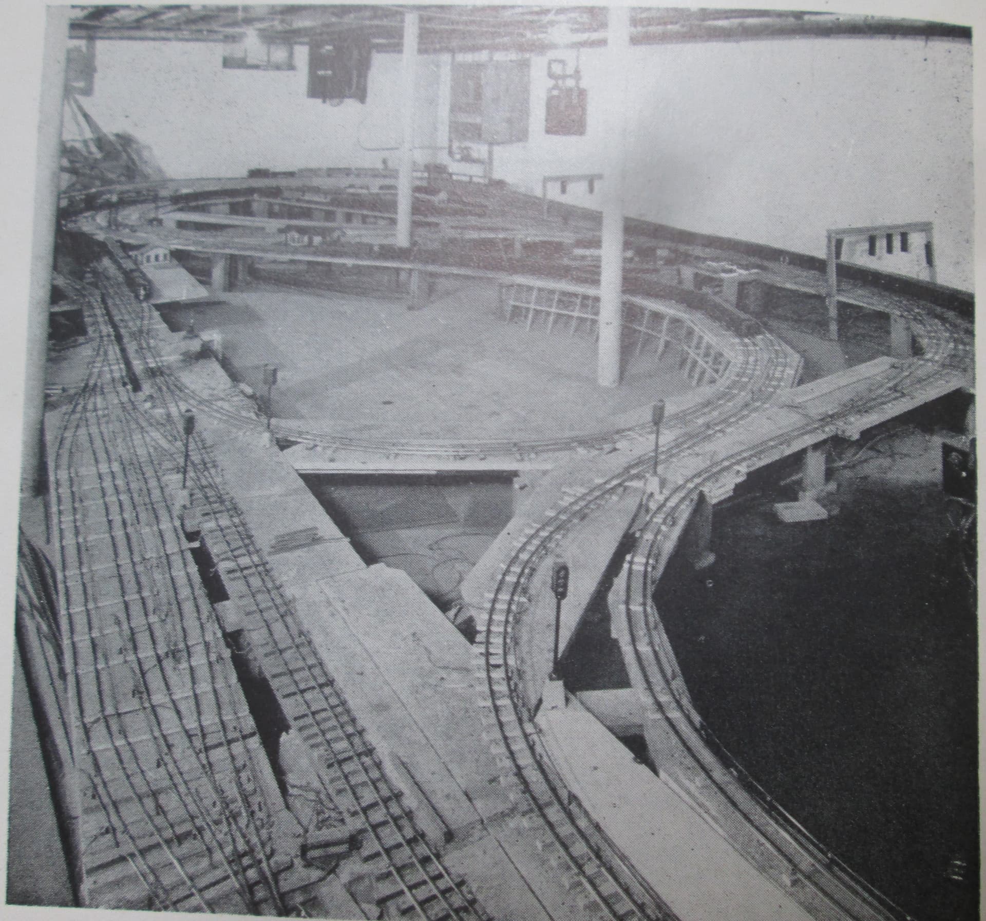

“serious” modelers from the 1940s (How to Run a Model RR) that are more into “operation” than looks. (note the signals)
“From the 1940s”. That’s 85 years ago. Doubt that you would see something like that built nowadays.
In the 40’s everything was built from near scratch, modelers, even groups working on club layouts had to choose their priorities. Note the outside 3rd rail in the photo, just as non prototypical as no scenery.
