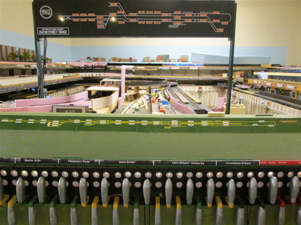

Here is tower of LION
Inside of GRS machine of LION. SPDT microswitches are already covered.
Inside are spdt micro switches. Levers in is normal, pull out to reverse the circuit. You can see even without thinking if your tower is in its normal position.
+12v DC (red wire) and -12v DC (green wire) are wired to the micro switch, the common line (or the stinger) goes out to the particular turnout. The local turnout has its opposite pole connected to the GROUND bus at what ever location the turnout is at.
