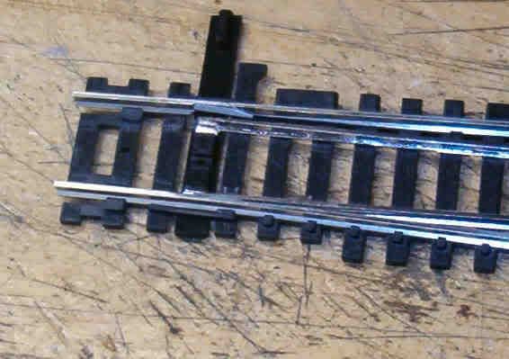

The problem I’m addressing is on the Custom Line mark IV turnouts, the stock rail is notched too deeply where the points come into it, making some rolling stock “hop” when they run through in the trailing point direction.
I’ve finalized my experiments and this seems to be the easiest and most effective way to cure this problem:
You need strip styrene .01 x .06 inch
Cut a piece of the strip 3/8 inch long. Bevel one end on the thickness (.01") to match the bevel at the end of the notch in the stock rail. Bevel the other end on the width (.06") 1/8 inch long and tapering from half the width to the edge. Super glue this into place. When the glue is dry, file the point to match the alignment of the stock rail. A picture may help:
Note in the picture, the styrene is white, the bevel on the thickness is to the left and the the bevel on the width is to the right.
