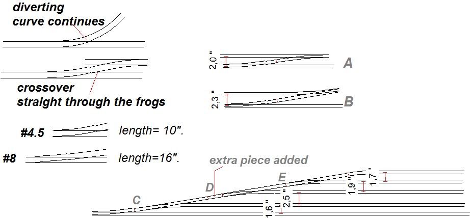

yes ,Ive herd of it being done with success ,but you must know that it can change the track to track clearance in certain ladder formats etc. I myself have not done it but would if needed . but I think your only going to pickup an inch or so . cutter beware …Jerry

the trick is to obtain the spacing you want. In situation A, i used two #6 switches right out of the box to get a 2 inch spacing. This is a standard value, that is probably why those switches are made that way.
Try to get 2 inches of spacing in other then cross-over situations.
Sometimes you have to trim, sometimes to add an extra piece of track.
Paul

Well, you can shorten them a little. But shortening a #6 will not make it the same as a #4, if that’s what you really need. A #4 has a sharper angle of divergence for one thing. So if a #4 is what you need, then you really should buy that instead and save your #6’s for where you can use them.

I’ve done this successfully many times. On all three tracks. You can’t get too close to the crossbar/points so that they won’t function properly. It is key to remember that you can’t change the basic approach(tangent/radius) too much however. For example you can’t have an 18" radius feeding into a reduced straight section going into the points and expect large locos to behave.
