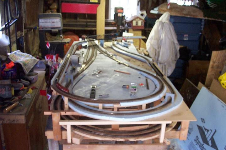

That’s exactly what I’ve got, too. I built my benchwork out in the garage, and even did a lot of track laying and scenery. I realized early on that the back edge of the layout under that sloped ceiling was going to be next to impossible to work on.
So, I used L-girders and joists for the basic frame, and stand it off on legs, with brackets attaching it to the side wall (the left end in the photo). You’ll also see that I have a low knee wall, about 24". You’ll also see that the basic benchwork sits over a foot below the back edge of the scenery. There’s really no point in extending the benchwork all the way back to the ceiling line, because you won’t be able to do anything with that space anyway. Using stand-alone legs will be easier to engineer, and more stable, in my opinion. You may include a brace or two attached to the ceiling, but I think that would be overkill.
Here’s the view showing the construction progress while still out in the garage. The track on the left side is now running directly under the ceiling at the rear of the layout.
To make sure I didn’t get too close to the ceiling and lose clearance for trains to run, I added a small ridge of landscape behind the tra
