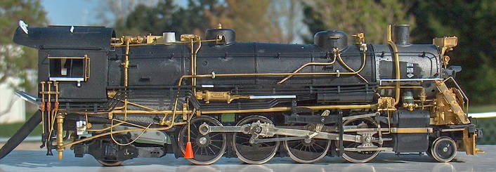

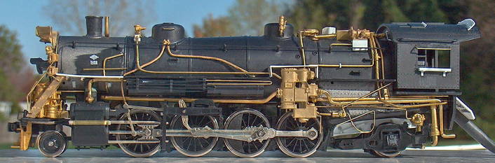

One idea is to solder some pins or pegs to the brass bands, drill the boiler and ACC the pins or pegs from the inside.
Lately I have been using Loctite Super Glue Gel, basically a thickened ACC to attach details to my engines. I try whenever possible to pin the details and glue from the inside, especially on a painted model.
