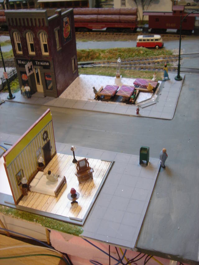

For my city street buildings, I build up the sidewalks on the outside of the structures, and fit the buildings into the resulting opening:
I put interiors into a lot of my structures, particularly those at the front of the layout.
The recessed bases keep the buildings from shifting around due to normal vibration, but I am still free to lift them vertically off the bases if I need to work behind them, for example. Also, by putting the bases below the level of the sidewalks, I block out any of the interior lighting and keep it from leaking under the base.
