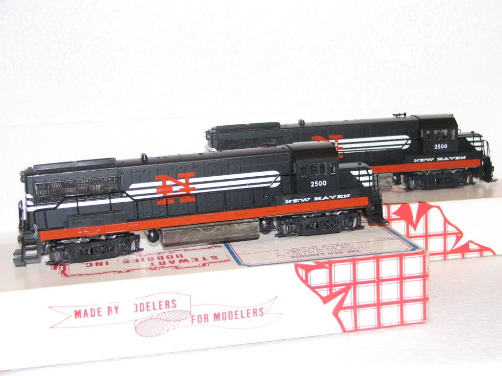

Just making nice DCC conversions of a pair of “old-stock” but “new in the box” Stewart U25Bs. They ran fairly well in the pretest, and I thought all was well.
When trying to quiet them down after the conversion, I found that 7 of the 8 axles in the locos had the old split gear problem. [banghead] I thought only P2K had this.

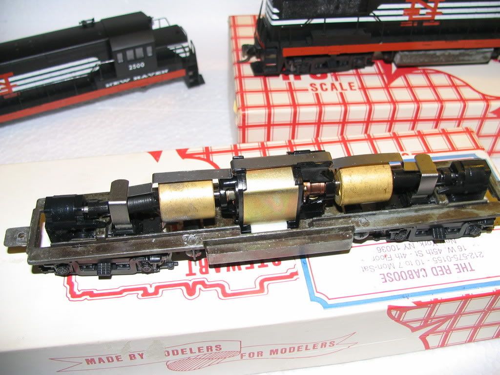

Can a forum member tell by looking at these?

I am not sure about early runs, either. But these are quite old models, I believe. The motor had a pickup from the frame and the locos didn’t have any lights! even though they were “brand new on the sprue” kits. Like P2k I imagine these axles just split as they were sitting in the boxes…probably the same undersized holes drilled that plague the P2ks. (Original seller seems to be The Red Caboose in NYC on 4th Street, which I googled just now and see it is still in business since 1946!)
(Didn’t add the decal to change one loco number yet.)
Anyway, the wheels look about 2mm larger than my P2k replacements. I don’t have a micrometer.
If you pop the shell off or give us a look at the underside we should be able to tell what drive it is.
Dan
Those U25Bs should have Athearn drives since they are the early run from years ago.
I can tell by the trucks.
I’m a little slow today…duh. Why didn’t I snap the pic like this first? Here is the unconverted loco’s drive.

Actually, it looks like my P2K brown box BL2s, except the motor on these contact the frame and P2k don’t. No…the P2k also have a soldered cable off the rail pick up.
Yep! That’s an Athearn!
You could either buy some axle gears from Athearn, spend some money and get the gears and some good NWSL wheelsets, or buy a replacement axle set from Proto/Walthers (They will fit the same as a Athearn)

That U25b has the standard Athearn 42" wheels/1/2 axels. You can get replacement gears from Athearn/Horizon, (I think the P2Ks are currently out of stock). The nicklesilver 1/2 axles are available from NWSL and JayBee.
Don’t forget to isolate the motor from the frame when you convert it DCC. I recommend you solder pickup wires to the brass rivets on the truck frames, (the rivets closest to the motor). You could also replace the motor/flywheel with a Mashima (A-Line) for a more complete upgrade.

The gear slipping on the wheels is the fact that your gears are split, which essentially means that the gear is cracked in half on one side. This would cause that gear not to be ‘stuck’ onto the wheelset, causing it to slip on it.
The same gears that you use on your P2K or Athearn locomotives will work on these engines (I.E. the Athearn drive is used on the early Stewart engines, as well as aspects from it used on the P2K locomotives).
Phil
Ya anytime you see those silver metal ‘tabs’ sliding along each other for electrical pickup, it’s an Athearn. Many folks ‘hard wire’ the connections rather than relying on the metal tabs. When Stewart diesels first came out around 20 years ago they used Athearn drives, later went to Kato. I think now they do their own??
