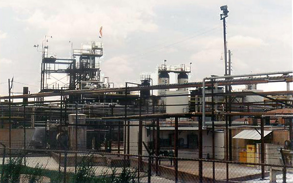

Inedible animal fat rendering plant, near the Fort Worth Stockyard, photographed from “Tarantula” tourist train, 1994.
