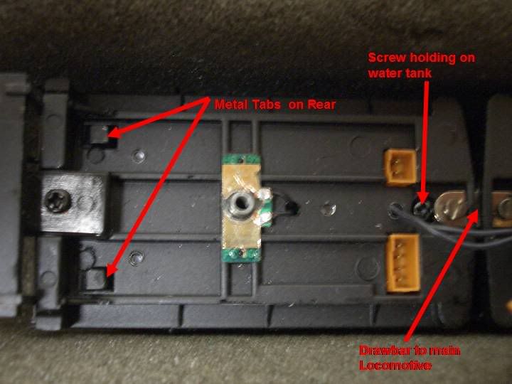

hi guys can you help.
ihave shay iwant to put a dcc decoder in the water tank,how do i get the tank of the chassie.

The little screws under the frame. If I remember right, there are two.
I put a decoder in their Climax and had to cut a capacitor they put in for DC opperations. I found a web site that expalined how to do that. You may need to do the same. It was easy, but necesary.
i don’t remember where but this was posted before. But I there is a screw that is hard to see unless you take the rear truck off. There are two metal tabs and a screw that hold the tank on.
Hope this helps.
THANK YOU FOR YOUR HELP. I NOW HAVE THE SHAY RUNNING SWEETLY.
