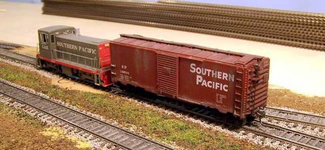

Hey Dave, glad to see you posting. Could you or some one post a PIC of the 70 tonner? Like to see what one looks like,

Is this the Bachmann DCC 70 ton being discussed here ?
