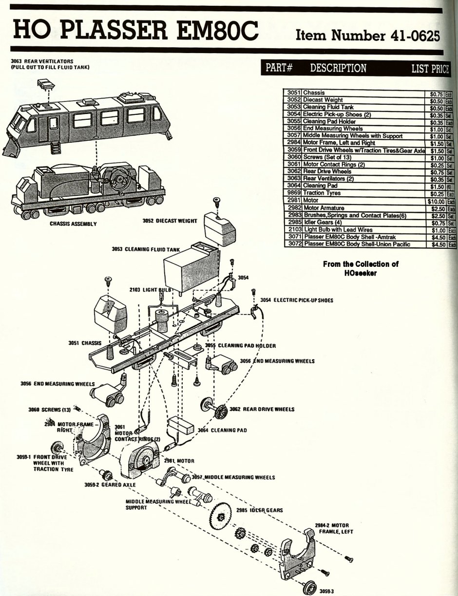

I found this 1990 diagram.
http://www.hoseeker.net/assemblyexplosionbachmann/bachmannplasserem80cdiagram1990.jpg
Forget simple. The motor has to be disassembled to isolate the two motor contacts.

Looking at the exploded diagram posted by Rich, methinks this model was made in Jolly Olde England, what with “Tyres” as the spelling for what we here in the U.S. call ‘tires’.
Probably was, as the parent company (Plasser) is Austrian, and they make those sort of things for the European railroads.
Funny though, in the parts list on the right, the part for drive wheel with TIRE spells it the US way, while the line item for just the traction TYRES spells it that way. Either whoever Bachmann had convert the sheet to US English missed all the others, or the other way around.
