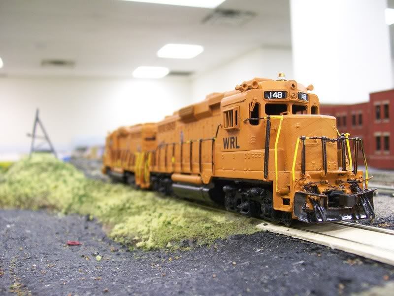

If worse comes to worse, a Blue Box Athearn GP35 drive should fit under it. Just a little grinding on the frame to make it fit.
I did my pair 17-some years ago.
The original drives had a bit of slop in them, lot of surging coming down a 4% hill with a decent train behind. Athearn drive works much better. I also added weight, 6-7 ounces or so.
After that, I decided not to buy any more. Luckily P2K came out with their GP30, which has a much better body and drive.
