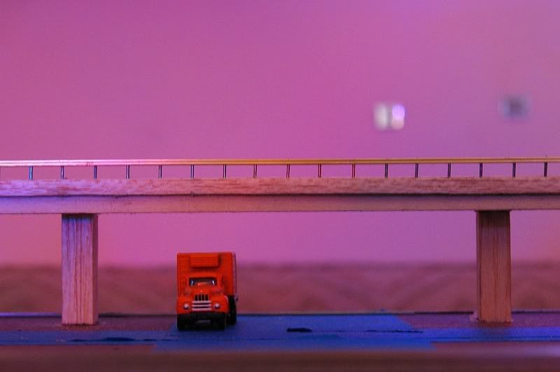

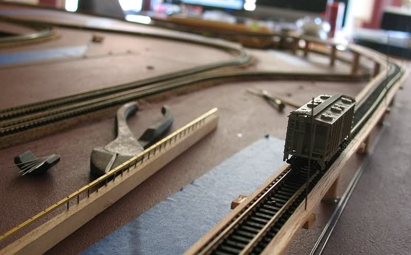

The elevated section is 7’ long. I struggled a bit with coming up with how to make railings for it. Here was my first attempt:
It looked toyish to me and was too far out of scale so I started over and this is what I came up with:
Making the guard rails is tedious but easier than I thought it would be.

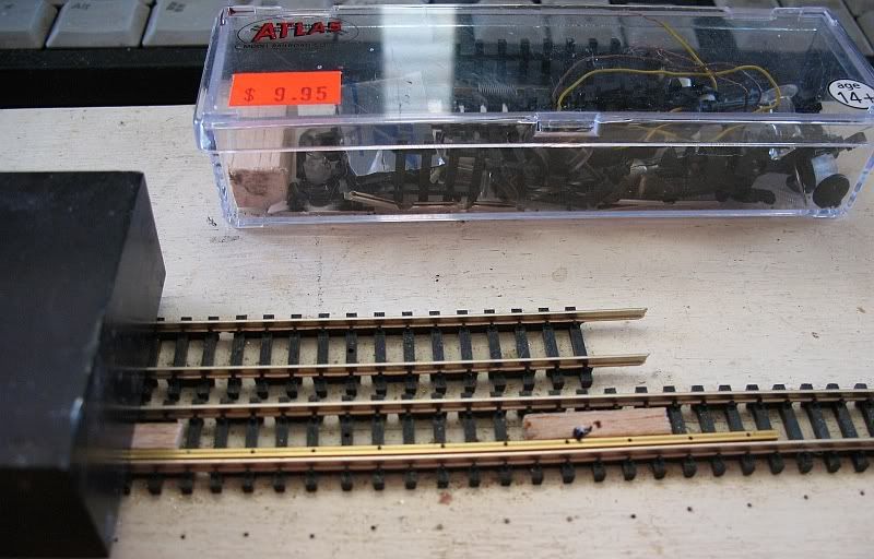

I first made a jig with some leftover flex track and drilled the holes at every other tie. No measuring just eye-balling it:

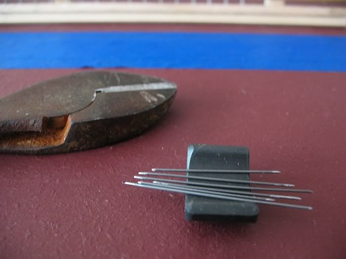

I use piano wire and balsa wood for quite a few things. I prefer balsa wood over bass because it is softer and does not split as easy. It also bends with less fuss. Once its sealed and painted it is quite strong. I also only use Elemer’s regular glue in case I make a mistake or want to change something.
I use magents to handle the piano wire and sharpen the ends with a dremel:

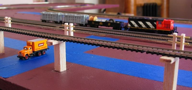

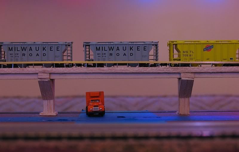

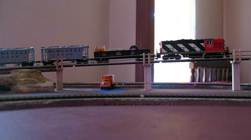

The only thing that would concern me is that really steep grade you’ve go there for the piers. That’s gotta be 20%.

As far as the steep grade is concerned. It rises 1" in 14" (7.1%). I know it is very far from prototypical but this is fantasy land. So far I can get the GP-9 to crawl 7 short cars up the grade with no problems (pushing and pulling). I had to remove the weights from the caboose though. I am not looking to run long trains on this layout and rolling stock will consist of mostly oar cars, beer can tankers and 2 bay hoppers. 2 of the main lines will be used for staging cars and longer trains will only run along the non-elevated tracks after coupling with the parked cars.

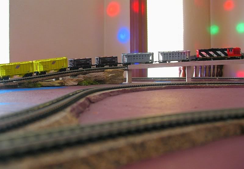

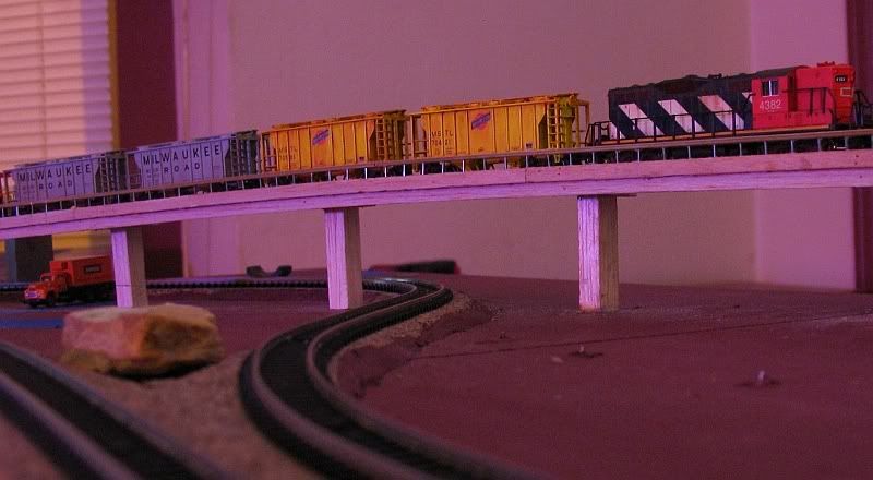

Today I picked up a couple of ore cars and promptly removed the proto weights. I also grabbed a Bragdon weathering kit and look forward to working with it. Eventually I am mostly going to run short unit trains with either all beer can tank cars or ore cars. The 2 bay hoppers will be parked along the 2 staging lines most of the time.

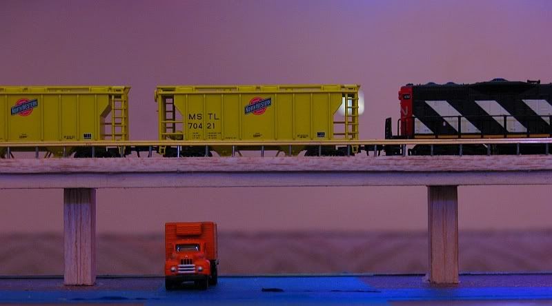

Here is a pic of a 7 car “shorty train” going up the incline:

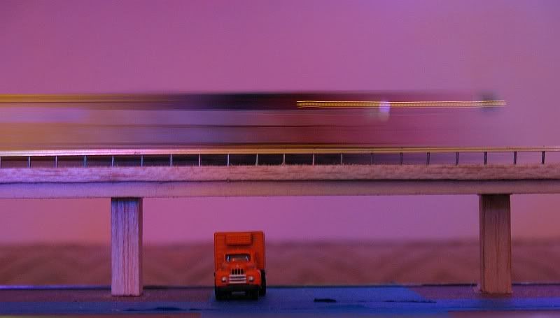

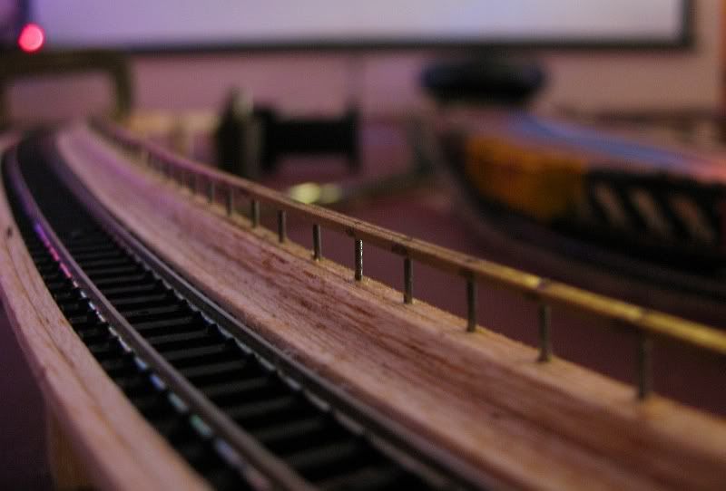

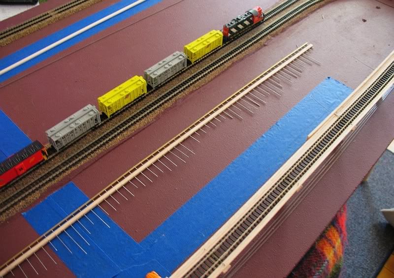

I managed to get a little bit of work in today on my elevated section and the railings:
I am going to cover up the ties with wood as well.

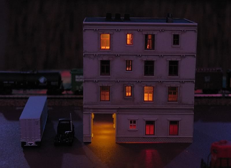

Here are a couple of night shots of my first completed building. I made the interiors and lit them with 7 wheat bulbs and 6 LEDs.
