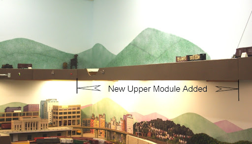

I look at backdrops or backgrounds as being made up of three distinct types of layers. Farthest away is a background that is indistinct. Next closest is a printed backdrop of specific scenes that can be made up of multiple commercial prints. The closest is the backdrop buildings that are plastic kits that are only 1/2, one, or two inches deep.
I start with a light blue for the walls. Then my farthermost background is sponge painted and is just some hill shapes. (It was my first time doing something like that.) It is not the best, but acceptable to me. On the middle level using commericial photos or prints that I use, I always cut the sky portion off.
Since you are a painter, it seems to me that you could do that really really well, then add some selected prints in front of it.
Although not a very good modeling photo, the one below shows what I mean. (Scenery on the upper level hasn’t started yet.)
