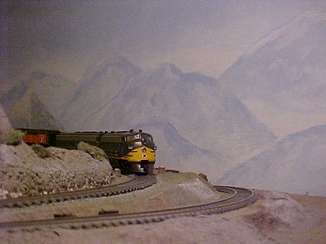

I was so canvas-challenged, I could not even draw butter for a lobster meal. While surfing The Net, I came across a really cool instructional video on painting backdrops by Darryl Huffman in Alaska.
Easy Backdrop Painting videos
I bought the video and within an hour was so happy with the outcome, I decided NEVER to buy another commercial backdrop. I now paint all my backdrops and even a few for friends with new-found confidence & skills.
Time & repetition have greatly improved the results but here’s my first effort at painting a backdrop after watching the video one time. Here’s an eastbound freight headed down the mountain. It was very easy doing this backdrop. You should consider buying the video.
