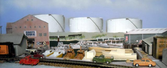

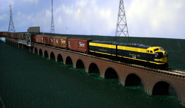

I went to a dealer in the industrial area listed under plastics, bought 4x8 sheets of styrene. I borrowed a pickup truck to carry it, but it rolled up easy enough to stick in the front passengers seat. Cut it into 16 inch tall strips.
I sprayed it with a special sticks-to-styrene spray paint from Walmart. Then painted sky with oil base paint sky blue at top blended to sky-blue-with-white mixed at bottom. Spray painted clouds using a hole torn in a old piece of scrap cardboard as a “stencil”. Sharpie marker for hightension towers.
Lots of Photoshop manipulated photos printed out and glued on.
Mockup of shrimpboat harbor to check background. I still need to draw rigging and paint nets for the background cutout shrimpboats.
