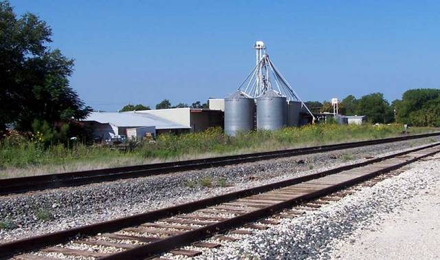

I was in La Grange TX this weekend and took these of the mainline and siding. This was the MKT line at one time … now UP of course.
