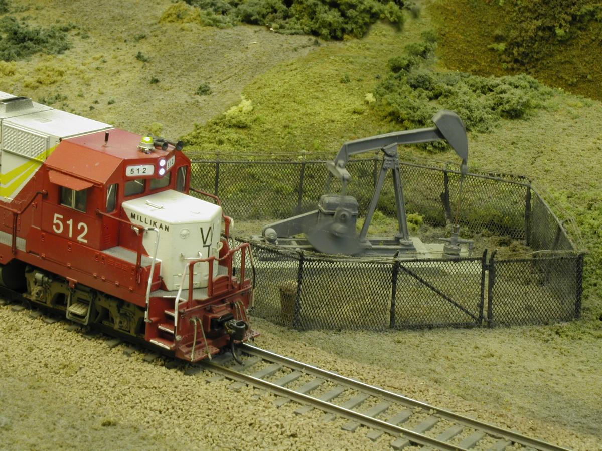

For reference, I’ve just put in a short section of Walthers chain-link fence. I assembled the framework and sprayed it silver, and then added the fence mesh and re-sprayed the silver paint. It looked very good, but way too much like brand-new fence, so I hit it with some Dul-Coat and it looked a lot better.
