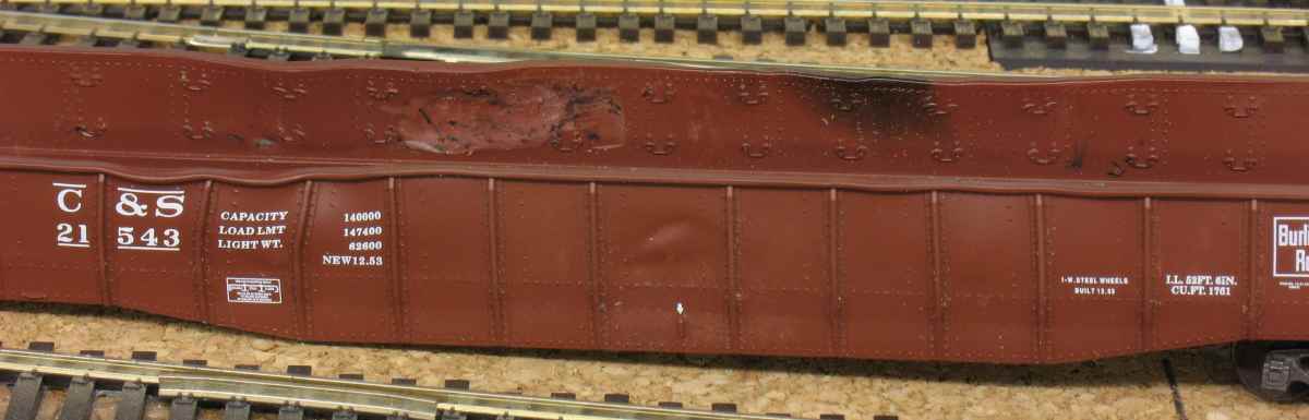

How do you make battered gondolas? My first try was with a candle, soften the body. I don’t like the result:
Any hiints?

That turned out GREAT![tup][tup]

I use a soldering iron, and then I will go with some sand paper and kind smooth it out. The problem with putting styrene pieces on the outside ribs is, the outside will be dented up, and the inside will be smooth. How is the outside beat up and the inside factory smooth. Doesn’t give that realistic look. There is a GREAT looking gondola on modeltrainsweathered.com and its dented on the inside and out. A few people asked how he did it, but no response.
The next gon. This time I’ve used a Dremel cutting disk. You see at some spots I cut through the board. [:)]
