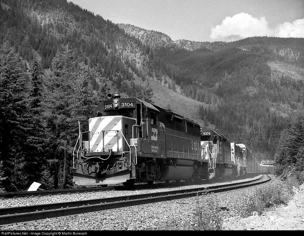

Anyway, I’m putting this GP50 shell onto a GP40-2 frame (both Athearn BB) to replace a Southern Pacific GP40-2 shell. I’m planning on modeling (loosely) BNSF, BN, and SF. Anyway, if you look at the pilots above, there seem to be no “plows” with hoses etc. My avatar is a good representation of the look I like. Here a larger photo:
Is this enough info? Thanks for the help guys.

You need the details west #155 plow for the BN 3125. The picture is of a ex frisco GP50. They were different from the BN ordered GP50’s. RRpicture Archives has some OK pictures of the 3125 that might help out.
