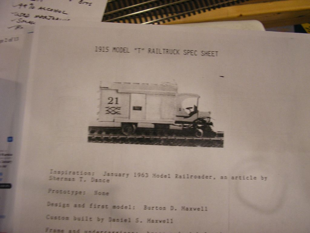

This one combined a Highway Miniatures school bus with a very primitive kit for a Model T truck. This is the kit:
This is what it was supposed to look like:
This is the result:
