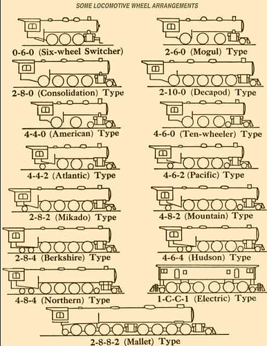

Hi everyone, I’m brand spanking new to this hobby and am currently trying to gather the basic information that most of you already know. I’ve been searching trains.com’s website for a couple of days now and have answered many of my questions. One question stands out in my mind still…
What does the three numbers on an engine mean? Example, 0-6-0. I have no clue how to even ask the question other than that so anyone that knows what I’m talking about please help.

[#welcome] to the forum. The numbers in question are the wheel arrangements on steam engines. The first number is the number of wheels on the lead truck. The second number is the number of drivers, or powered wheels, and the third number is the trailing wheel set.
By the way, there are engines with 4 or even 5 numbers. My screen name comes from one such engine. It is a 4-8-8-4, that’s 2 sets of 8 drivers.[swg]

In regards to your second question. A steam locomotive like an 0-6-0 or a 4-6-2 and so on and so forth. That is known as the Whyte system for identifying steam locomotives. (Named after some guy names Whyte) The First number is the number of Pilot wheels a locomotive has. (Pilot wheels help guid or “pilot” the front of the locomotive into a curve.) the second number is the number of Drive wheels. and the last number is the number of trailing wheels

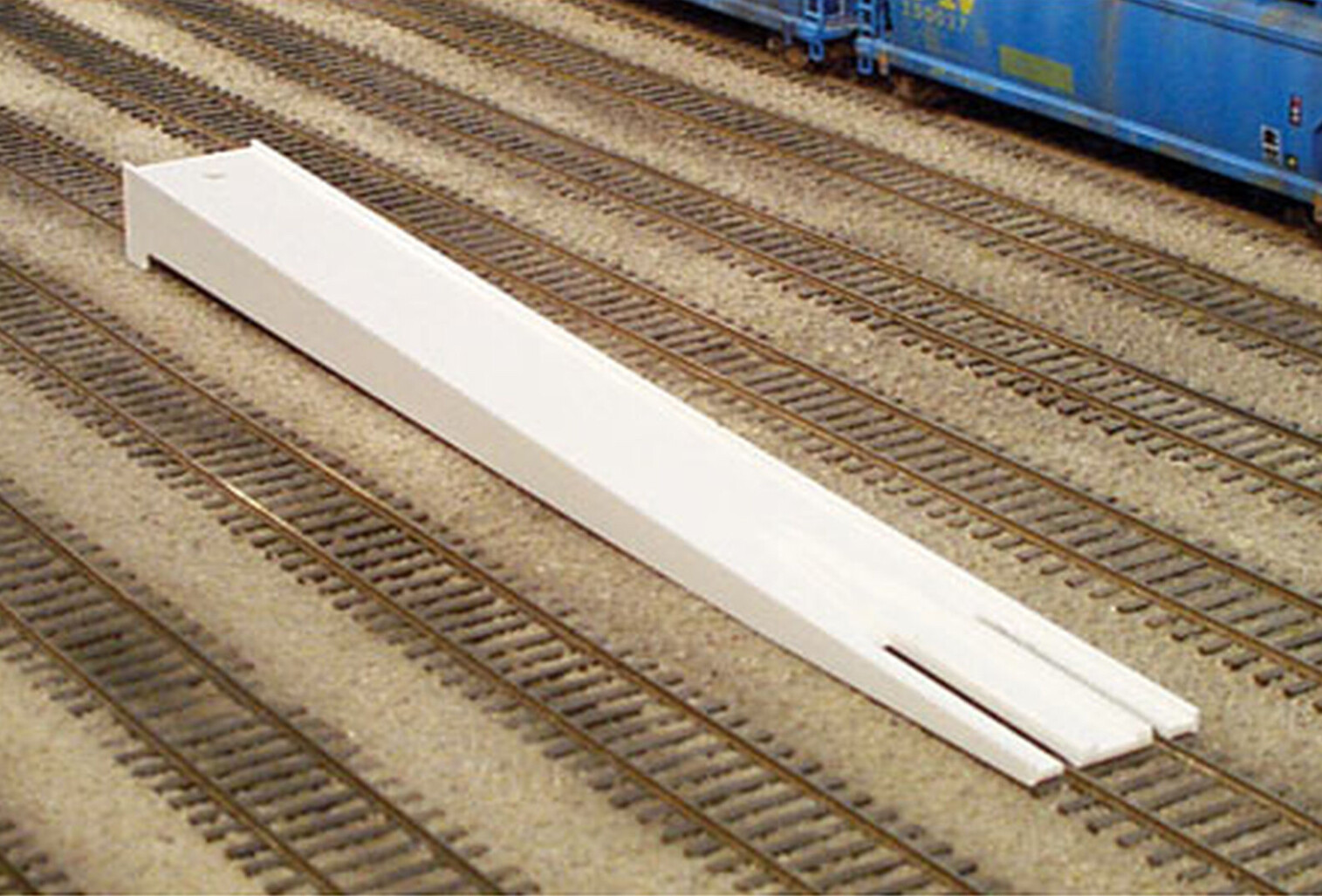

If rerailing rolling stock is causing frustration, get one of these rerailers available from a number of manufacturers. Just Google “rerailer HO” or for whatever scale you’re working in.

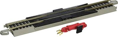

Elaine, first, take your fingers and run them along the top of each rail where the pieces of track join together. It should be smooth at every joint. If it isn’t, take the two pieces apart and put them together again, taking care to make sure each rail goes into the rail joiners. That can be tricky on this type of track.
If the joints are smooth, then something like the rerailer mentioned above might be a good idea to make sure your cars are fully on the tracks. Depending on the brand of track you have, you may have something like this already. For example, the terminal track for Bachmann’s system looks like this:
What looks like a road crossing functions as a rerailer. It may take rolling the cars back and forth across it a couple times, pressing down on them gently, to do the trick. You’ll know you’ve got it when they roll perfectly smoothly.
