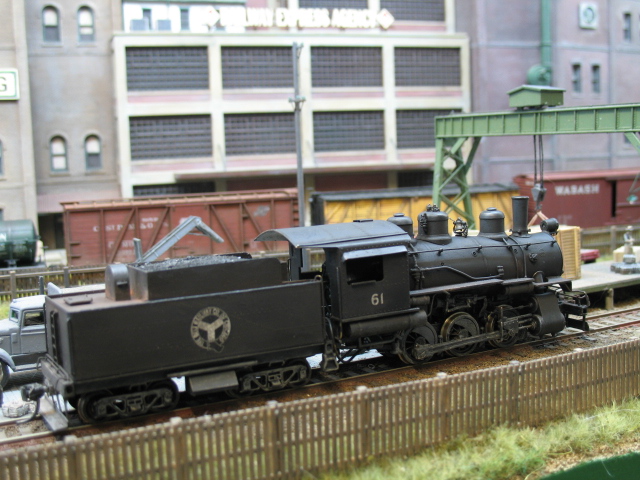

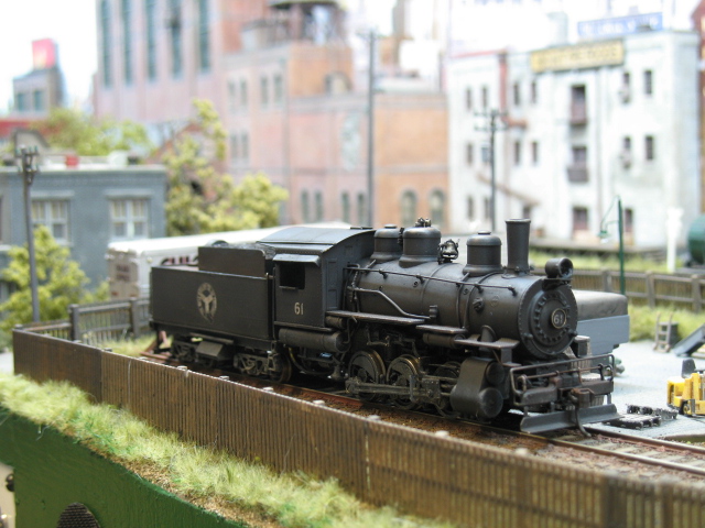

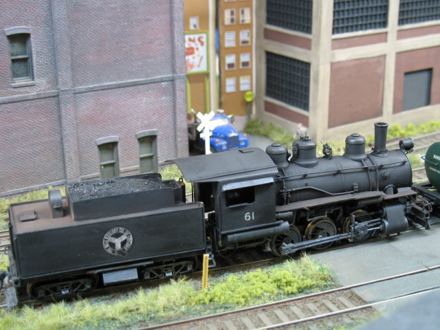

I spent a good few evenings modifying a brass switcher from an oil burner to coal and adding sound.
Before
The main alteration was to unsolder parts of the tender and build up coal doors and add a coal load, followed by some heavy weathering.
