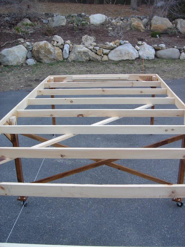

This is an old picture of my original benchwork. It’s 5x12 feet, and I model in HO. The outer frame is 1x4, the cross-rafters are 1x3 and the legs are 2x3. I put this on casters so I could roll it around the room, to make the back easier to get at during construction.

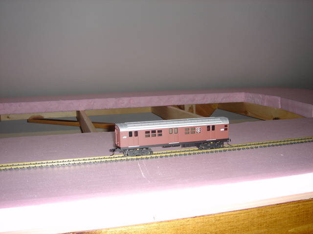

Here’s another shot:
This is a very easy construction method, and the results are sturdy but light. I used a pink foam base for my layout, but I didn’t put down complete sheets. I left openings for parts of the layout that would be at different elevations.
I find the pink foam to be very easy to work with. I can cut down into it easily to make railside ditches or small ponds. Scraps can be glued on to form the base of small hills. Mostly, I cut it with a knife or foam cutter, leaving very little mess. It takes paint and glue well, too.
