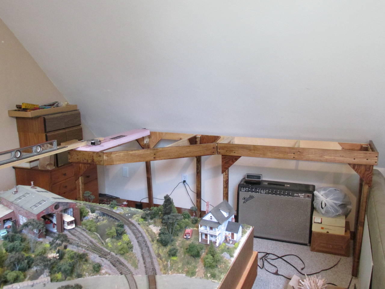

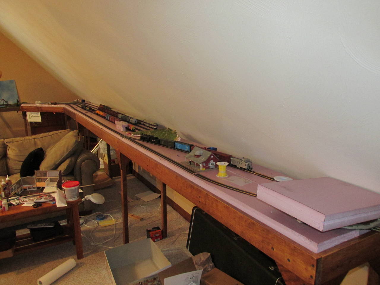

I spent $150 on my benchwork for a 14 x 16 layout. Did not use the typical methods but I have a strong background in building so relied on that mostly, also I wanted some larger areas for some specific scenes:
This would be my second choice if I couldn’t attach the layout to the walls and avoid legs alltogether.
