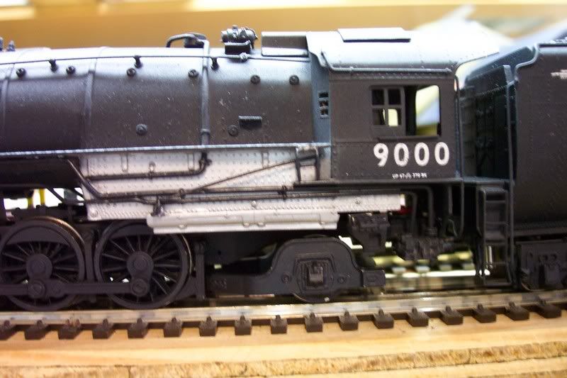

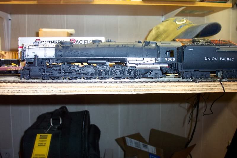

Here is what I used. I was told that Smokeboxes & Fireboxes were painted Graphite. So I bought 2 bottles of Floquil. (1) bottle of GRAPHITE and (1) bottle of OLD SILVER. If you look at the Graphite it is way to dark. I added OLD SILVER drop by drop to the GRAPHITE till I was able to match the color very close. Then just masked with 3M tape, airbrushed and then with a small brush painted the piping that was sprayed Graphite and Silver.
