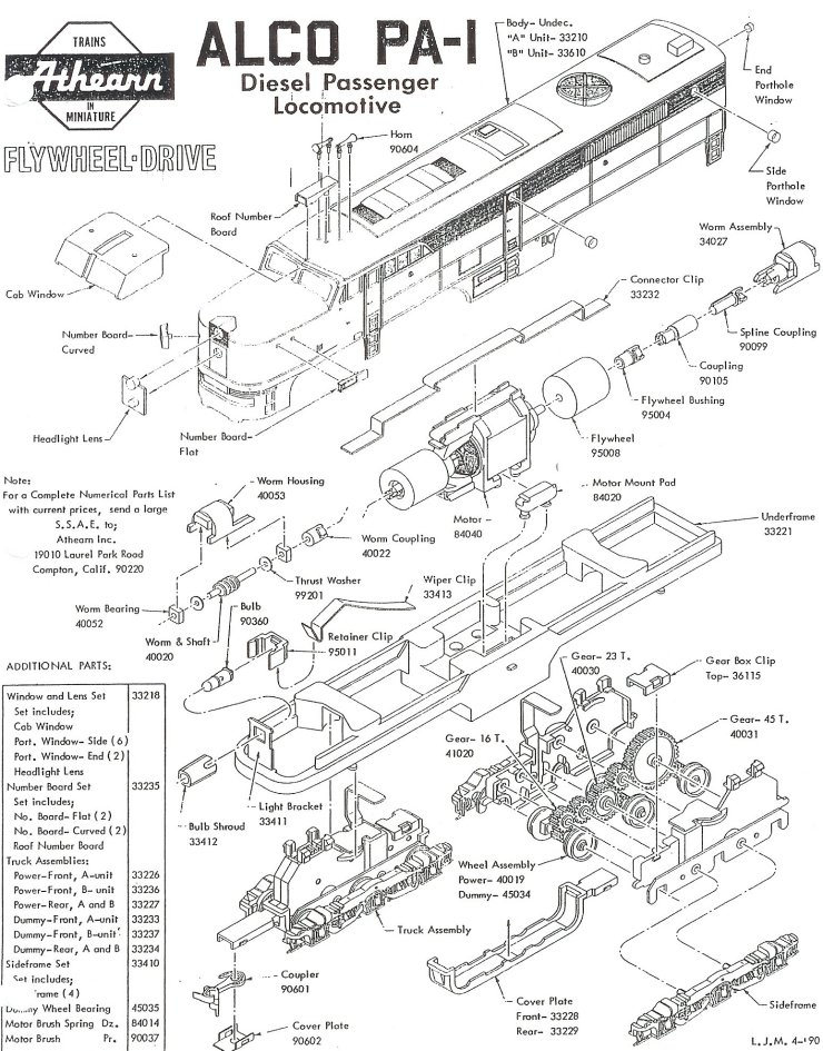

Looks like Athearn had at least 4 versions of the PA1. If you have lost the part diagrams, you can probably find your particular model here: http://hoseeker.org/athearn.htm.
All of them seem to have the same large gear I believe you are talking about. That would be part 40031 on the following diagram, http://hoseeker.org/assemblyexplosionAthearn/Assembly%20Explosion%20Athearn%20PA%201%201994.jpg, which is the 1994 version.
I think the side frame assemblies are different between some of the versions. The 1970 version has a post or gear stud, part 42006, on http://hoseeker.org/assemblyexplosionAthearn/Assembly%20Explosion%20Athearn%20PA1%201970.jpg
