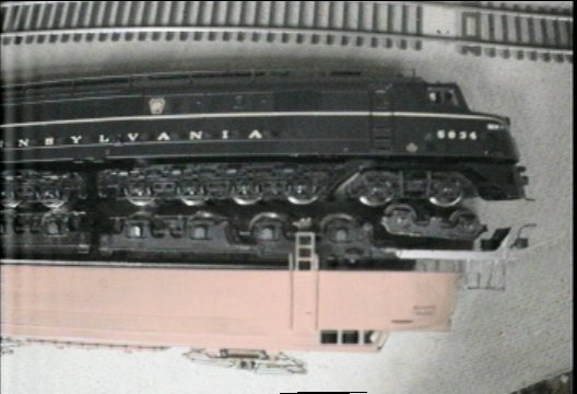

mine just arrived, still in box , just got home, pics later
quick test run, very nice. Good sound, didnt even hit the horn yet, well, one blat test., starts creeping on throttle 1 setting. One word. Big. One unit is just short the Y6B maybe 20 feet. My South Shore little Joe is just shy the centipedes length. BLI has flexed the front porch. 24 inch radius the overhang is big still. This engine is better on larger radius I don’t care what model maker claims how sharp radius these engines like this can take, they are better on larger radius 28 inch, 36inch even better, you will still have overhang. The engine derailed on a bad part of my track, this is why I value such an engine to help define track problems and fix them. Looks like I got work to do 8-D I have a good size long dogbone test loop so I can get some cars behind this for a test run, I’ll fix my track before this. Still waiting for my Athearn Turbine to arrive.
They do sound nice don’t they? Unusual sound at start-up though. Almost like an added “doppler” effect to the engine sound. And the really are big, approx 25.5 inches for the two combined.
http://www.youtube.com/watch?v=IFU0uqXaCsE my quickie video, done on an old AMD system 950mhz Duron using a Matrox Mystique Rainbow runner and a Big Picture camera (US Robotics) to capture, the camera is NTSC with an RCA plugin to the Rainbow runner. Works great, I could a have done a higher quality but 56k here, video size, 3 megs. Fixed my little track problem goes over the mini-bump fine. I started adding cars to it and put them on a crawl and kept adding cars as it crawled. Got up to 54 cars. Ran it around, and in a few areas of the test track it spins slipping, barely, I hike it up and it gets going. Pretty heavy train, mostly hopper cars and others. So ran it around a few times, no derails (yay! well one minor boxcar a wheel off, old mantua or something with big coupler pocket interfering with wheels, pulled it off, added 2 hoppers). Soooo, I decided to try the BLI Y6b to compare, and it walked away with the train no slipping. Looks like the Centipedes could use a little more weight test layout has 24 inch radius with some wider maybe 30 inch.
