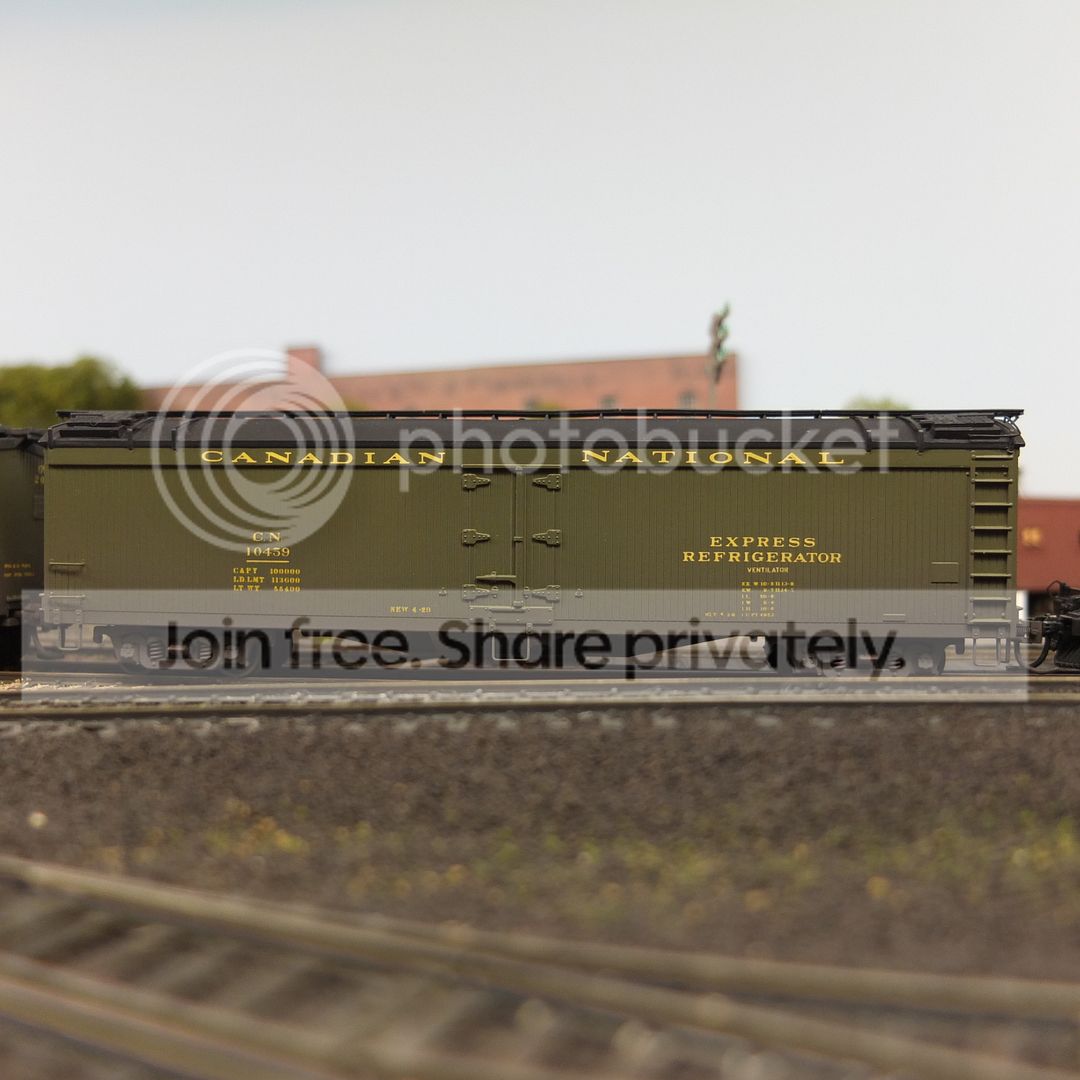

This is my Athearn Blue Box express reefer, with some slightly modified details…
…lettering is C-D-S dry transfers.
If your car is lettered for CPR, it should be CPR maroon, rather than boxcar red. The Black Cat decals are very well done and much more correct than they were many years ago.

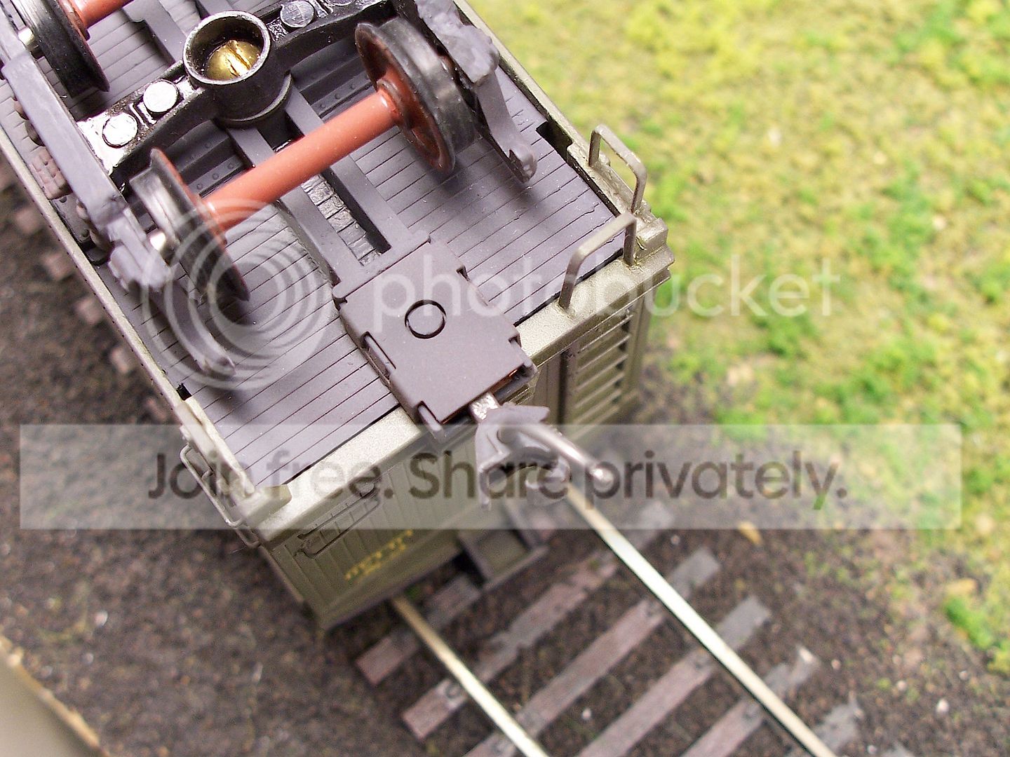

I also added a few extra parts for the brake gear…
…and used Kadee #5 couplers, with the Athearn snap-on covers…
There are two Kadee #209 (.010") grey washers on each of the truck-mounting bosses of the car’s bolsters, putting the couplers at exactly the proper height.
