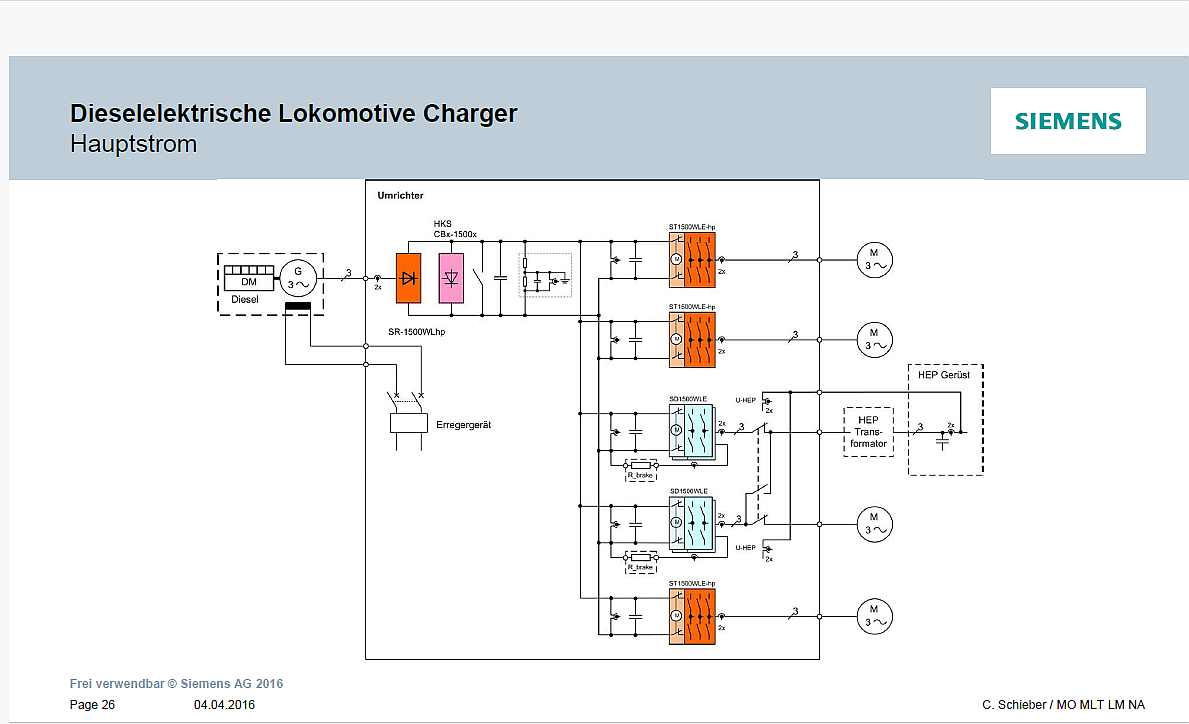

Perhaps I am simply misunderstanding the first sentence. The predecessor to the SD70MACH—the SD70MAC—had one inverter per bogie. The SD70MACH, with its B1-1B wheel arrangement, was equipped with one inverter per driven axle, plus two for HEP—one of which serves as reserve.
The Siemens Charger is slightly different. With a B-B wheel arrangement, it features four inverters—one for each axle. In addition, there is a dedicated inverter for HEP. Should this unit fail, one of the traction inverters serves as a backup.
Main power schematic of the SC-44 Charger. The schematic for the ALC-42 is identical:

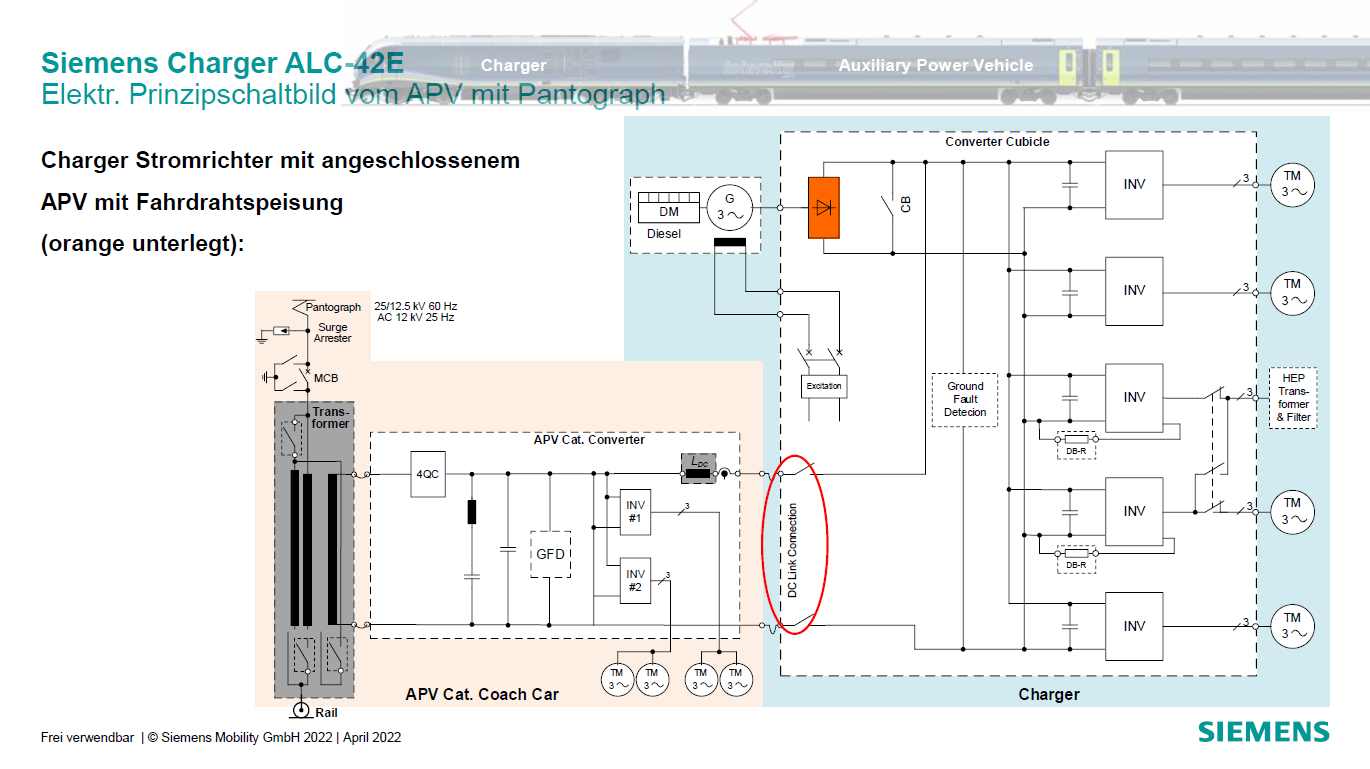

And for comparison: the schematic of the ALC-42E with Cat-APV.
