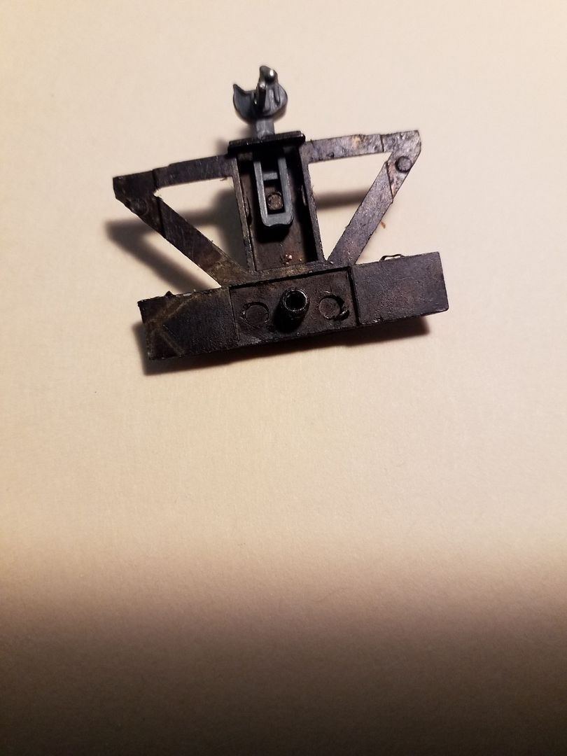

But not as much as I ended up doing, not fully understanding how the parts go together despite having those very clear and complete photos to work from.
Ignored Rule One in model railroading. Carefully examine whatever it is you seek to improve, repair or modify BEFORE lifting a screwdriver or knife or any tool.
I could not see any seam between the end of each of the bolster castings and the rest of the underframe. The whole thing looked continuous, as a plastic moulding would be. I failed to notice that the main underframe was composed of pressed steel beams. Nicely done. The bolster/coupler castings were so exact they fit perfectly against the rest of the underframe so tightly it all looked like one casting.
Removed two screws to take off the trucks (each screw is also sprung which is a very nice detail ). Each truck had two Kadee fibre spacer washers.
The other two screws are very short and removing each yielded the dreaded clunk of a nut falling off inside the car (turns out these screw into little weight bars, also a neat touch.)
The body lifts off. The ends kind of fall off, held on only by the two wire end rungs. And still no closer to the backs of the couplers.
THEN I looked more closely and noticed the ends of the underframe including the bolsters were separate castings, as in the photo. But no sign of any fasteners. Turns out the makers exploited a handy characteristic of sheet metal: punch a hole in the sheet metal and you can create a raised sharp lip around the hole. Press a round metal anything just slightly larger than the hole into it from the punched side and the sharp edge will grip whatever that is. The bolster castings just press fit into these punched holes. The truck screws fit into the studs that press fit into the car floor. Sort of prototypical in that the trucks aren’t actually fastened into the underframe.
I pried off the bolsters very carefully r

Oh I did wait. Even with your priceless information I still managed to screw things up. Fortunately, not seriously. I did get to fully understand why someone like me might want to own one of these and update it just enough to run it with more modern models. Kadee to the rescue. Athearn still won’t use Kadee, weird.
Without your information it could have been worse. Thanks v much.
With your help I’ve preserved another little piece of modelling history.
I’m very pleased with myself.
Even though I’ve no right to be.
