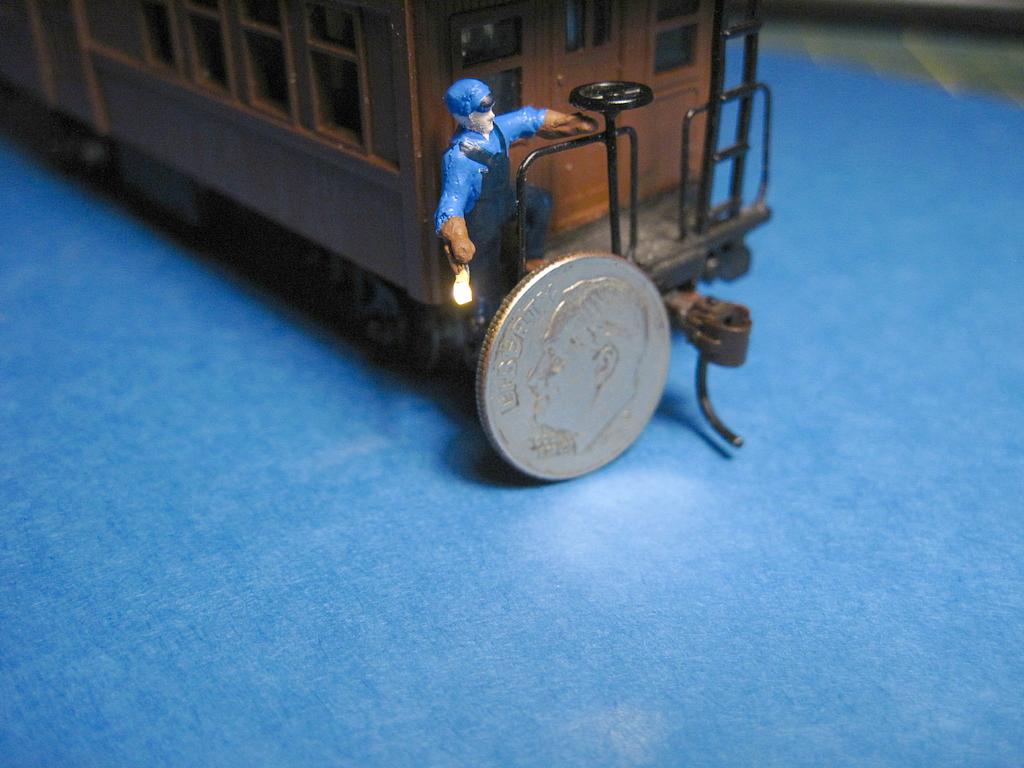

I’ve been drilling a .021” (#75) hole in a leg of my figures and gluing a .02” Phosphor/Bronze wire as a mount. An empty .021” mounting hole doesn’t show up unless you’re looking of it.
For my conductors carrying lights I glue them to a male micro connector and the female connector is in the caboose steps.
All of the figures in my scratch builts are plugged into .0
Mel,
I like your “people mounting”.
But I especially like your guy with the lantern.
