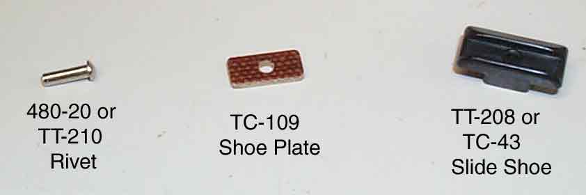

I just spent some “quality time” in the train room comparing the PWC die-cast log dump and coal dump cars with late 1940’s versions in my collection.
Other than some more modern wiring in the new version, and the absnce of a large hole in the bottom deck of the new log car, they appear to be the same…
EXCEPT:
The contact rivet on the flying shoe is so small on the newer version that it rarely if ever touches the control rails.
Solution: buy some after-market flying shoe assemblies and swap them out.
Is it an ideal solution? Nope. The car worked well when I got it, but the rivet head has worn down quickly. Much quicker than the 1949 car I’m comparing it against.
One other thing: I also disassembled one of my Operating Track controllers and used some emery cloth to polish up the contacts. Watch for the tiny plastic separator nub. It’ll fall out as soon as you remove the stud screw.
But once the contacts were polished I got much better operation out of my dump cars and milk cars.
Jon [8D]
Jon,
You could also just get some repo rivets and shoes and “backdate” the new trucks. Might be cheaper and saves a pair of trucks, but either way would work for sure. I have a few new ones and an army of older ones but we haven’t dumped anything in a few years[:-^] got get more stuff up and running…so I wouldn’t know how good or bad the new ones work.
At least they aren’t rusty yet and don’t have crumbly wiring[swg]
And here are the parts & #'s for the rivets, shoes, & backing plates from The Train Tender:
Rob
