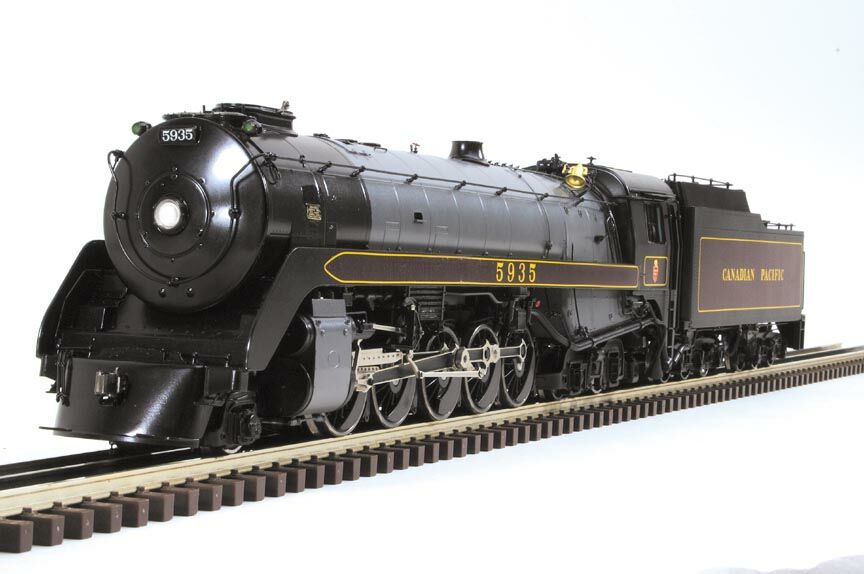

I saw an advertisement for a Brass Selkirk by Sunset and noticed it had a minimum turning radius of 30". When I went onto the sunset Website I saw a NP Challenger with a 30" Radius.
I have an Athern Challenger that can handle a 18" radius and a Broadway 2-10-4 that can handle 22" radius. and 5 x 2-10-2s that can handle 22"
My question is: Is the 30" radius a conservative number or are the tolerances different for the brass? I really would like to know as I would love to get the Selkirk. And maybe the Challenger…

Yes, the tolerances are a lot different for brass, as is the market each is aimed at.
Bachmann, Athearn, BLI, etc. are aimed at the mass market, and make efforts up front to make their models take a very small, pre-specified minimum radius, regarless of how ridiculous they might look doing so. Extra lateral motion is provided in the drivers, and details that might interfere with a pony or trailing truck’s swing are modified or eliminated.
OTOH, brass locos provide less lateral motion for the drivers, and use metal pony and trailing trucks which will short when they touch fine details like brake and steam lines. Articulated brass models usually do not let the rear engine pivot (same as prototype), which raises the minimum radius for these models. For these reasons, brass models generally have a higher minimum radius than mass-produced equivalents. And if CNJ’s theory is correct, many brass models were built for the collector market, and operational capability took 2nd fiddle. A collector doesn’t care what the minimum radius is.
How much below the manufacturer’s specs you can go depends on your willingness to modify the model to make it work. Most manufacturers are going to be a little conservative to allow for production variances from one model to the next. Modifying low hanging details to permit swing room for pony and trailing trucks without short circuits would be the next step to reducing minimum radius. But the reduced lateral motion of drivers is going to be your end point because changing that is going to mean major modifications.

No, if anything, when the loco’s specifications are 30" then I would consider 32" to be the practical minimum.

Lovely! Make a grown man cry!
